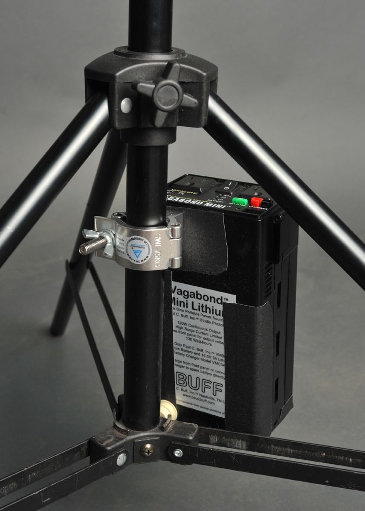

I had been wanting a better way to attach my Vagabond Mini Lithiums for location mobility, so thank you to Rob Galgraith for doing the heavy lifting in his review here of the best alternative clamps:
http://www.robgalbraith.com/multi_pagea ... 1667-11915
Of the ones he reviewed and tested, I opted for the Global Truss clamps. Of the three sizes of this clamp Rob mentions, I found the "junior" to be the closest fit for the tube diameter of my lightstands. I made just a few mods, though, to make them work a little better:
- I placed gaffer tape on the VML where the bracket screws in to prevent turning of the bracket and gouging of the VML's housing.
- I placed 7 layers of gaffer tape in the arches of the bracket - where bare metal would otherwise touch the metal of the lightstands. This helps the bracket hold more snuggly to a few different diameters of lightstand tubing, and prevents the bracket from sliding down easily.
- I put a couple of rubber bumpers (round and light yellow in the photos) at the base of the VML to help it rest against the lightstand and prevent stress on the threadmount on the VML.
Here are photos on my Flickr stream of this approach:
http://www.flickr.com/photos/92211832@N ... 0087718096
This makes for a sturdy mount that has a fairly small footprint, is flexible, and very cost effective, you might want to look at these clamps. I bought mine from B & H for about $9.00 each:
http://www.bhphotovideo.com/c/product/6 ... Clamp.html
Craíg
http://www.craigwasselphotoart.com

Well...that was kind of the point. For the price of one VML bracket and a super clamp, you can make 3-4 of these with a lower center of gravity.

Actually - though maybe not in this thread - the VML Bracket has been noted and recommended here in other threads and in other forums around the web, and with good reason. It is a very solid mounting approach. Rob Galbraith endorsed it as one of his top two solutions in this article which I linked to a few replies up:
He gave an equal nod to the Global Truss clamp, which is what I ended up going with and what I posted photos about above. I went with the Global Truss clamp instead because of:
- portability (considerably smaller)
- cost (far less)
- speed of use/mounting
These are extremely important to me since I use my Einsteins/VML so much on location. The simple and inexpensive mods I made to the Global Truss which you can see in the pic above and on my Flickr link greatly minimize the advantage the VML Bracket has of providing a more secure mount. If my light stands got heavily banged and bumped around to the point that the Global Truss was not strong/secure enough, then probably more than just a battery or thread mount (read: Einstein) would get broken as well.
Other advantages to the Global Truss + the mods I did? You can mount it anywhere: above the bottom lightstand knuckle, below the bottom lightstand knuckle (see the examples in my Flickr link), or anywhere vertically on the lightstand. With most medium size lightstands and with the Global Truss/VML mounted below the bottom knuckle, you could completely collapse and fold the lightstand, pick it up as one, and change locations without removing anything. That is a huge advantage to me when on location, and another reason I did not go with the VML Bracket.
Craíg
