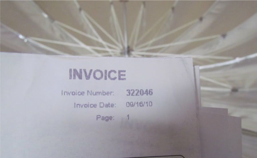

We have no "86" silver version 2.0 from Feb 2011 (has square pattern fabric)"
^got my date mixed up: Sep 2010

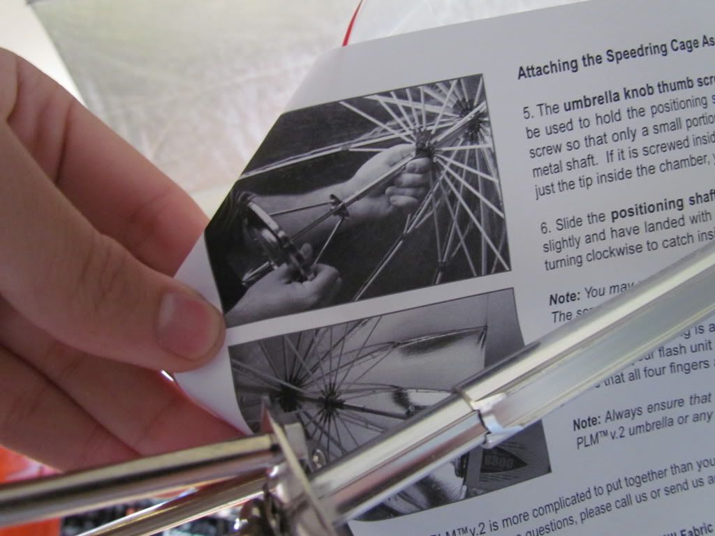

If memory serves me right (am i getting older already?), I placed my order at the time the silver plm v2's were announced to be available so that is what I'm going on. From what I understand plm v1's did not yet come with a speedring and v2's did. So to confirm, do i have a v1 plm with a v2 speedring?
How do i properly focus the plm to achieve your results? I posted my setup info and all i'm trying to do is replicate to understand the shadows and falloff with the einstein + plm combo so i know it's strengths and weaknesses.
I mentioned to c2thew that my V2 fabric doesn't look like that either...it's almost like he got a PLM w/ a different fabric on it. This is the weird square pattern in his gallery:
http://s62.photobucket.com/albums/h120/ ... G_0883.jpg
What's puzzling is they all seem to be V2's because they all have speedrings:
http://s62.photobucket.com/albums/h120/ ... G_0917.jpg
and he did test w/ an Einstein...
That ring effect might be interesting for beauty shots...looks like it might look like a beauty dish w/ that brighter outer ring...

Total puzzle to me. We never made a V2 Silver With square pattern silver on it to my knowledge. Almost sounds like a prototype somehow got sent out, but I have no idea of how. Doesn't even act like the V2 arc shape.
Why not call Lori at customer service and we'll replace it and scratch it off to a supernatural event!! I just emailed her to do this.
As for focusing, if you are within 10' of the subject, place the flash tube about 2-3" in front of the PLM outer perimeter. If you are like 20-40' away, move it in to approximately parallel.
If indoors, I use the modeling lamps and visually focus for smallest brightest center. If out doors, I go to subject position and adjust focus (using model lamp) for even filling of the PLM from out perimeter to center.
The new Soft Silver is hardly affected by focus position and just setting it with tube parallel to the PLM perimeter will be pretty optimal for about any use.

Thanks so much paul. called lori and she is sending out a replacement. I'll fix the post since i now know that the v2 i have isn't a v2 and I don't want to spread misinformation.

I double checked. Seems a small number of early V2s indeed had square pattern fabric. But as far as I know, the arc shape is correct and the only difference should be in output. But to be sure, I'll ask Lori to send you a call tag for the weird one so I can test it myself and be darn sure. I'll give you time to compare them yourself first, OK?
I do my design work at home and don't always see what gets shipped . . . close to 1000 packages per day.
