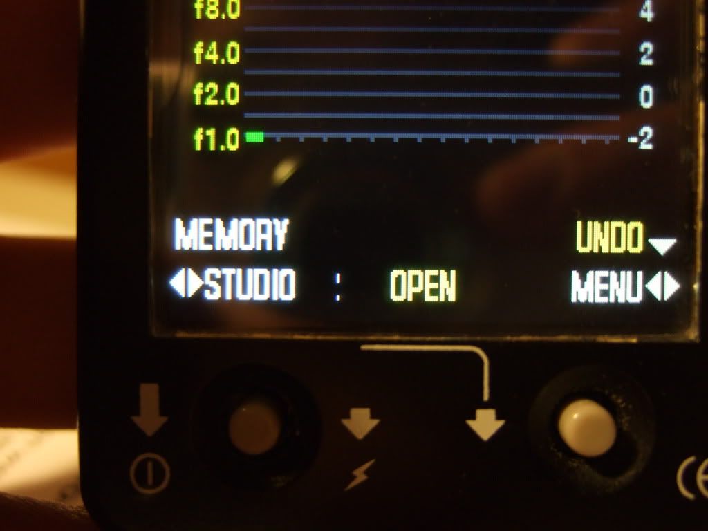

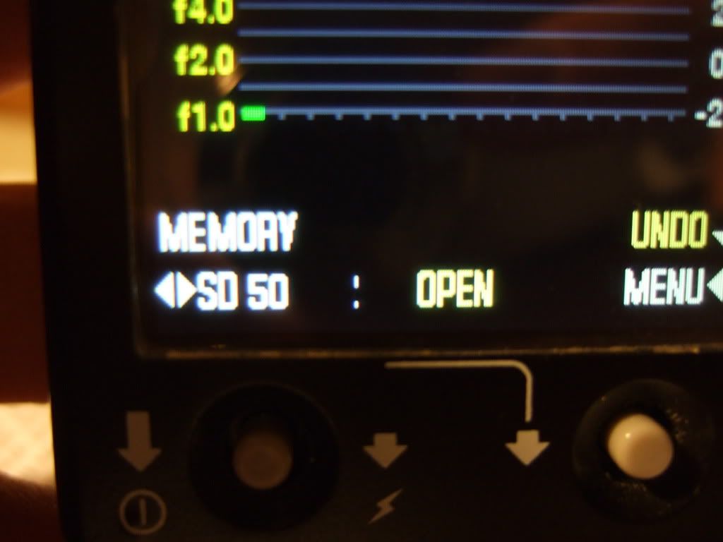

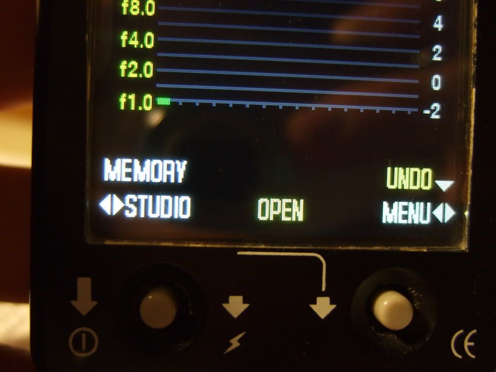

I updated to the newest firmware but I've noticed that there is some hot pixels that stay lit when you cycle from Internal 2 and Studio which didn't happen with the v.36. If i exit that screen and then go back into the Open Memory feature the white pixels disappear from the right side of the "2" It's more of a minor text bug then anything else.
The hot pixels go away if you exit into the menu

We have noticed the remaining pixels. Since it does not interfere with the operation, we will correct it on the next firmware release.
