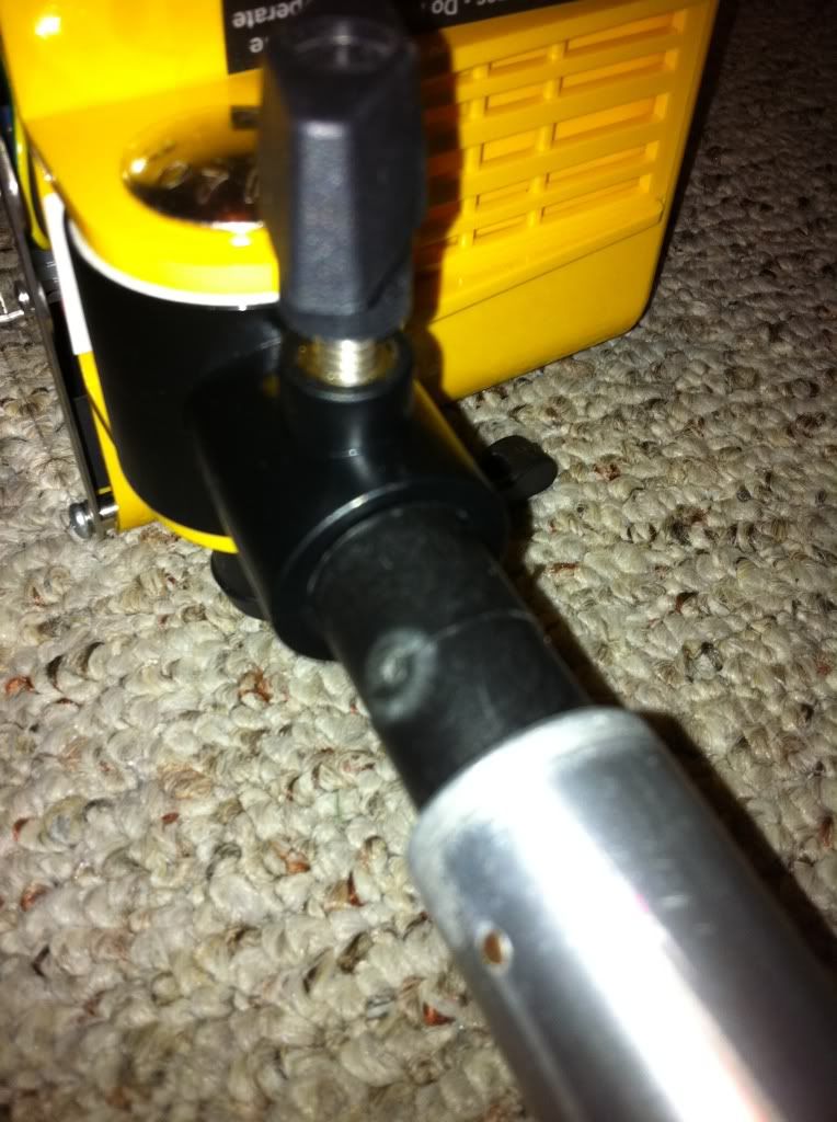

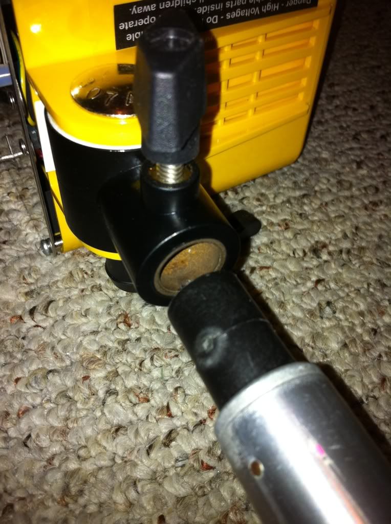

Sorry it took a while for me to post pics.. been busy
see how it couldnt fit... so its not 5/8" right? what size do you think it is?

Is the black piece threaded on, or does it have threads on the end in any way (male or female)?

I'm not familiar with the Norman, but it almost seems as if it is missing something. It seems like there should be a threaded hole in the end of that pole so that you can screw in a standard mounting stud.
In any case, to work with what you have, you could add a SuperClamp near the end of the boom. It clamps securely to the boom (or other things if need be) and includes a normal stud that you can mount the AB to. You might want to get an extra long stud, separately, to give a lot of grip area for the AB.

Looks to me like the standard brass 5/8" "stand coupler" is missing from the Norman Boom. From the pix, it won't fit any studio flash
