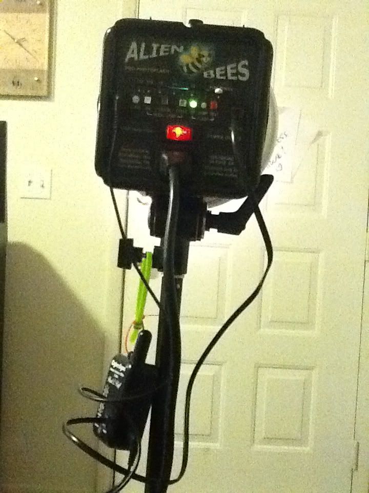

Wed Oct 05, 2011 9:19 pm
Joined: Sun Jul 24, 2011 8:06 am
Posts: 99
Hooked up right?
