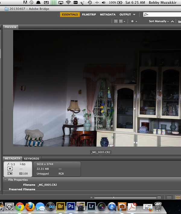

There is test shoot :
please help.

Thank's for your atention.

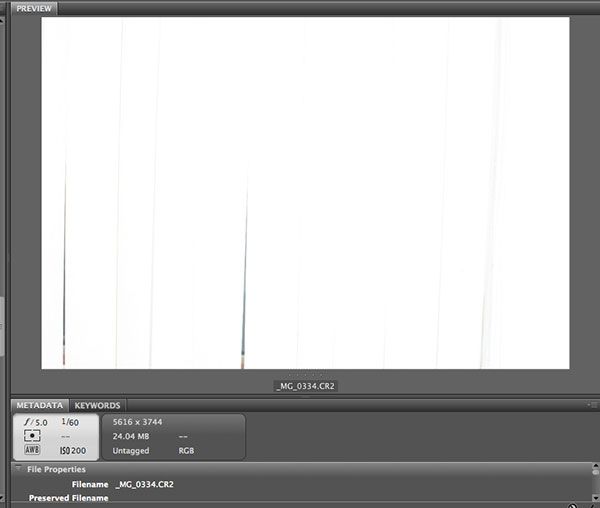

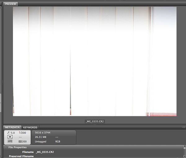

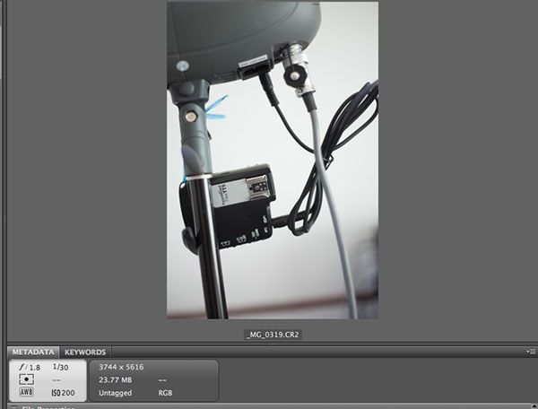

I used PW mini TT1 and Flex TT5.

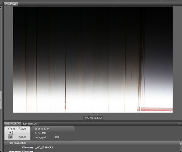

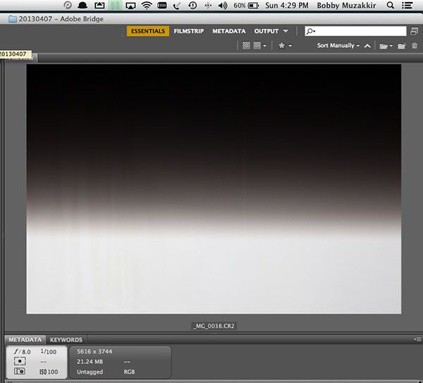

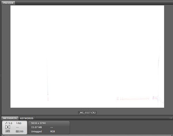

I had setting PW and the result is :
I used my PW + Visico, the result is :

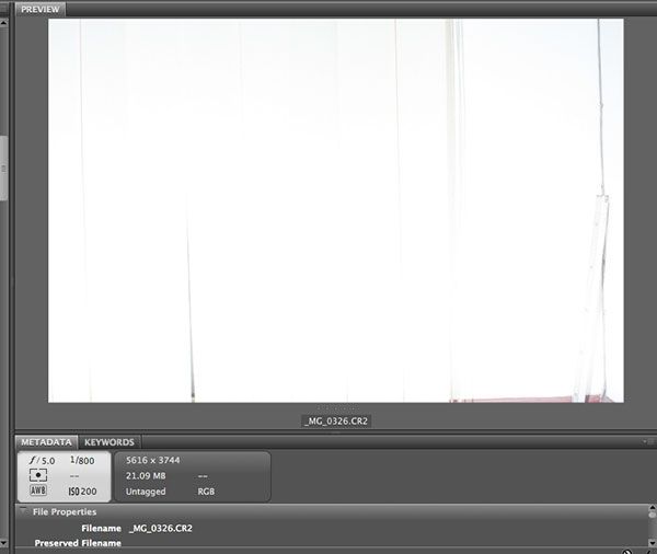

Hi,
if my AB is normal why there is like black screen in top of my foto
and if i use my visico no like black screen on my foto
speed is 1/800
Mon Apr 15, 2013 6:42 pm
viewtopic.php?f=8&t=66
viewtopic.php?f=8&t=67
These two threads will fully discuss this. But what you are seeing is the difference between a short flash duration vs. a longer flash duration. You do not specify which Visico you have, so I cannot give you a definitive difference, but it is flash duration related.
What is happening is the PW triggers the light, the shutter opens, the light completes its burn, then the shutter finishes its travel. The flash duration is shorter than the travel time of the shutter. This is very similar to the x-sync being exceeded, only the opposite.
Your visico can burn long enough for the shutter to completely finish its travel, and does not result in the black bar.
