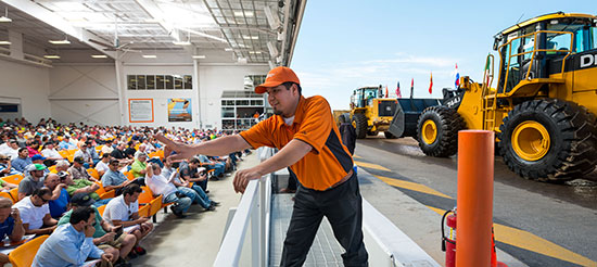

Hi there. I realize this is an old thread, but I thought I'd add my experience to this. I work for an industrial auction company. We sell equipment in a large auction theatre where I often shoot photos using 8 White Lightning Ultras rigged to the ceiling (similar to a sporting event see the following URL for an image of the environment https://www.rbauction.com/cms_assets/im ... media2.jpg).
I use Cyber Commanders for triggering in this environment. Over the years we've added wireless data for our customers and radio traffic in the 2.4 GHz range has increased considerably in the environment. At times my successful trigger rate falls to as low as 11% (one in 9 attempts). When I test the set-up at the beginning of the day or at the end (when the wireless activity is low) the system works at close to 100%. But when 500 people are using their wireless devices in the space the success rate starts dropping to really low levels. I can only guess that the wireless data network is creating a noise floor or interference that the remotes have problems competing with. I have tested other triggers that operate in a different frequency range in similar conditions at a similar facility and have noticed less effect.
All this to say that if there is free wifi in your environment it might be causing interference with your cyber synch system.
