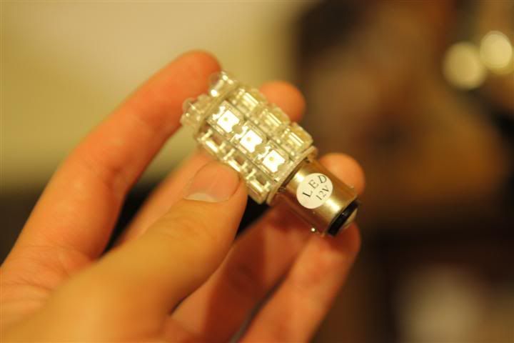

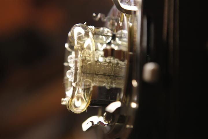

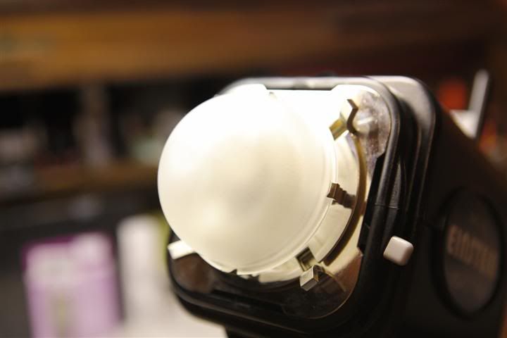

I had already ordered the led bulbs when i had posted and tried putting them into the einstein.... what happened next was incredibly shocking: the fuse blew up making a loud firecracker-like POP that left me in complete awestruck :o The plastic lid from the fuse popped off due to the pressure from the fuse explosion but i'm happy to report that the einstein was ok, just a blown fuse, an einstein that is down for a week, oh, and a bruised ego. (I have two einsteins and switched the fuse just to make sure the lightbulb didn't brick the einstein). it's a good thing i didn't have a wedding to shoot this week but i will definitely check with paul before i try anymore lightbulb endeavors.
led bulb in question

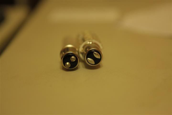

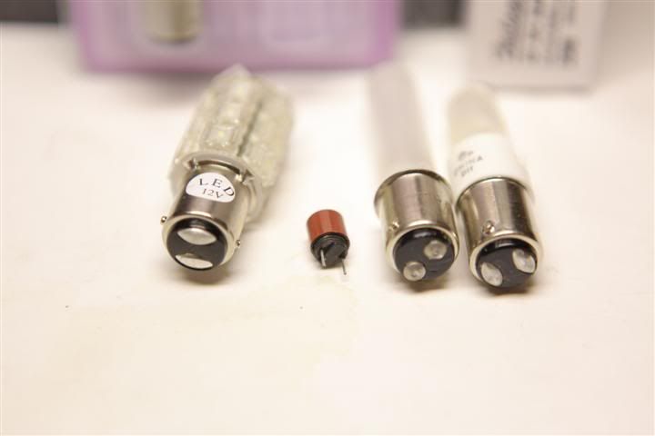

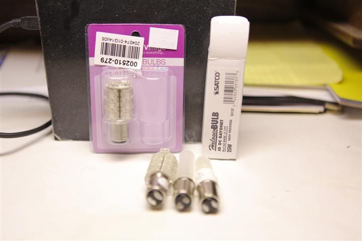

What triggered my decision to purchase the LED bulb: seeing the similarity of the base of the 25 watt bulb and the led bulb purchased on ebay.
comparison between the led bulb, the stock bulb, and the 25 low output watt bulb
stock setup.
led bulb fits perfectly centered in the einstein.
side shot
glass dome fits over the led bulb.
the blown fuse amongst the lightbulb test.... sad day.

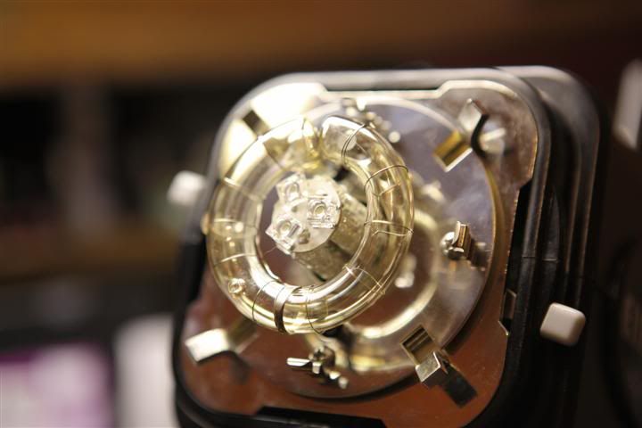

I really want to find a LED substitute for the einstein because the stock modeling bulb generates too much heat to be used for long periods of time.

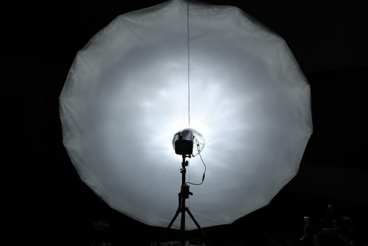

This is what I wanted to achieve (Note, this is a bike led light Magic Shine hidden inside the plm, sitting on top of the einstein not the led bulb. I recommend this light if you do night biking http://www.amazon.com/Magicshine-MJ-808 ... 398&sr=1-2)
close to the color balance that I was seeing in real life.
auto white balance with the 5d2
exaggerated blueish tones to get an idea of what kind of color the led bulb was emitting.
