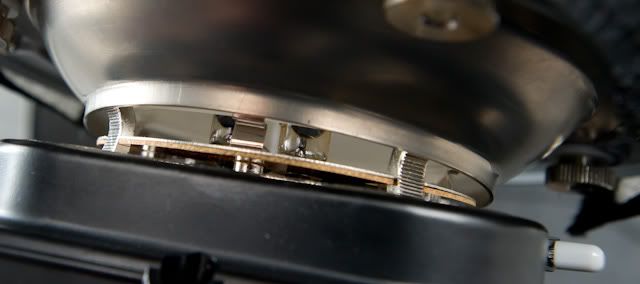

Here is the view from the top of one of my units
Side View
